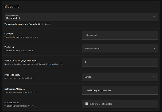

I also had this question and made an automation for this based on calendar events. It works like this: you create a calender with the (recurring) events, and the automation adds them to the to-do list for you. You can choose to notify specific users this has happened. You can find it here. Hope this helps someone!

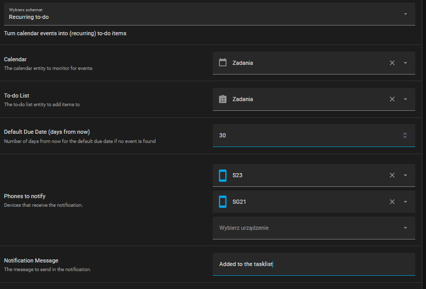

Hi Marcel, by searching how to manage recurrent (mostly monthly) tasks I v found this post with your solution and it seems to be the right thing for me!
Though, i feel like I’m missing something
Let’s say that my use case is to store tasks ie for kinderparty and additional lessons payment, in November (September payments are done)\i have calendar with tasks, and automation based on your blueprint; what to do next ?how this suppose to work ?
while adding task to calendar it should be picked up by the automation and then based on the number days added to the todo list ?
