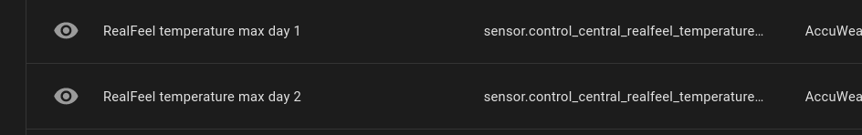

I’m using weather.accuweather but I can’t figure out how to get the forecast max temperature for the current day. In the picture below, it would be 89°F. The max temps don’t show up in developer tools. Any suggestions?
My goal is to use the max temp to determine whether I’d like the skylight shades to close.

There’s a sensor for that I think…
There is a variety of them for min, max, and in the sun and in the shade.
Don;'t need to screw with forecast if they give you a sensor.
Thanks @Sir_Goodenough but the “RealFeel” is usually different than the predicted high unfortunately. Looks like I have to dig into @Didgeridrew 's suggestion.
It should be close enough to estimate when to close the shades or whatever. It’s not a recipe for distilling vodka or something.
We have to contend with a good bit of humidity in our area in the summer which really skews the realfeel. For instance the realfeel max for today was 96.8 when the predicted max temp was only 89. At either of those temps, I would like to close the shades but on cooler days the difference might not give me the results that I would like. I do appreciate that you took the time to reply.
