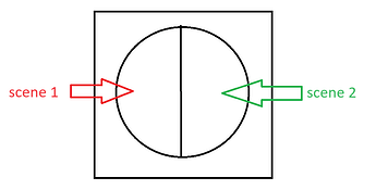

However, in my bedroom, I have a double wireless switch to light up a single ceiling bulb. The left button of the switch (scene 1) turns the light at its full power and the right button (scene 2) turns on the same light, but 50% dimmed.
When the light is off, things are perfectly right : I push the button I need and the scene comes up, but if I want to switch to whatever scene when the other is already on, I first have to turn off the light and then turn it on again on the desired scene.
So, schematically, here is my wish :
From OFF to SCENE 1 : press SCENE 1 button
From OFF to SCENE 2 : press SCENE 2 button
From SCENE 1 to SCENE 2 : press SCENE 2 button only once
From SCENE 2 to SCENE 1 : press SCENE 1 button only once
From SCENE 1 to OFF : press SCENE 1 button
From SCENE 2 to OFF : press SCENE 2 button
The switch I use : Legrand 067774 control via MQTT | Zigbee2MQTT, combined with a Philips Hue RGBW bulb
I’d be very grateful if someone could help me on this concern. I trief to look at the YAML to try to figure it out by myself, but I’m no coder at all :roll_eyes:
For what you wish to perform it is required to know if a specific scene is active. Since scenes don’t have a state in Home Assistant it is not possible to tell if SCENE 1 or SCENE 2 is active. This makes it not possible to implement what you have in mind. Or at least not that I am aware of.
