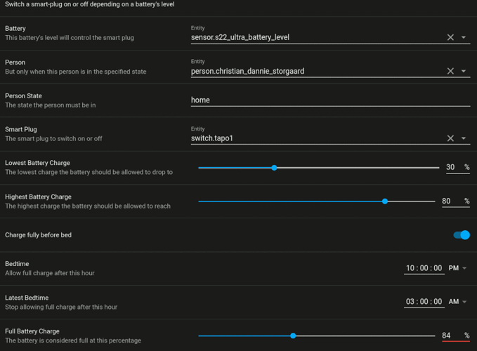

Toggle switch on/off by battery (phone) level
This automation will switch on your smart plug/relay if your phone (or any other battery) drops below a minimum percentage and turn it off again when it reaches a maximum percentage. It also includes a toggle to allow for a higher maximum during certain hours to allow for full charging before bed, as well as a condition that the owner of the device should be in a certain state before triggering (i.e. don't switch the plug if I'm not home).
Requirements
  • A switch that can be turned on/off with switch.turn_on and switch.turn_off
  • A battery level sensor, such as the one in the Home Assistant app
  • A person entity, such as the one created by the Home Assistant app
Note
While posting this, I noticed there's also a similar blueprint that just turns a plug off at a certain battery level, so if that's all you need, take a look here: 🔋 Turn off phone charging after the phone is charged
Disclaimer
This is my first blueprint and I have a suspicion things could be made simpler by calculating more using variables.
Update
I moved the set variables into their own variables block for easier debugging and also used the battery state directly instead of through the trigger. I think this make the blueprint a bit easier to work with.
The URL is now also a proper git repo instead of a one-off, so updates should be automatic now.
Update 2
I simplified the logic to use choose instead of a template and also let the plug stay untouched if the battery level is not in a state that needs action.
The import link to this post doesn't work though and I have no idea why.
Figured it out: the blueprint has to be at the bottom of the post.
Update 3
Added trigger for person state change, so the charger can turn on when you get home.
Blueprint
Click the badge to import this Blueprint: (needs Home Assistant Core 2021.3 or higher)
Or you can import this Blueprint by using the forum topic URL:

  name: Toggle charger by battery
  description: Switch a smart-plug on or off depending on a battery's level
  domain: automation
  input:
    battery:
      description: This battery's level will control the smart plug
      selector:
        entity:
          domain: sensor
          device_class: battery
    person:
      description: But only when this person is in the specified state
      selector:
        entity:
          domain: person
    state:
      description: The state the person must be in
      default: home
    target_switch:
      description: The smart plug to switch on or off
      selector:
        entity:
          domain: switch
    charge_min:
      name: Lowest Battery Charge
      description: The lowest charge the battery should be allowed to drop to
      selector:
        number:
          min: 0
          max: 95
          step: 5
          unit_of_measurement: "%"
          mode: slider
      default: 30
    charge_max:
      name: Highest Battery Charge
      description: The highest charge the battery should be allowed to reach
      selector:
        number:
          min: 5
          max: 100
          step: 5
          mode: slider
      default: 80
    use_bedtime:
      name: Charge fully before bed
      selector:
        boolean:
      default: True
    bedtime:
      description: Allow full charge after this hour
      selector:
        time:
      default: '22:00'
    bedtime_latest:
      description: Stop allowing full charge after this hour
      selector:
        time:
      default: '03:00'
    charge_full:
      name: Full Battery Charge
      description: The battery is considered full at this percentage
      selector:
        number:
          min: 75
          max: 100
          step: 5
          mode: slider
      default: 85
variables:
  battery: !input battery
  charge_min: !input charge_min
  charge_max: !input charge_max
  charge_full: !input charge_full
  use_bedtime: !input use_bedtime
  bedtime: !input bedtime
  bedtime_latest: !input bedtime_latest
trigger:
  - platform: state
    entity_id: !input battery
  - platform: state
    entity_id: !input person
condition:
  - condition: state
    state: !input state
action:
  - variables:
      charge: '{{ (states(battery) | float) if is_number(states(battery)) else 1 }}'
      is_bedtime: '{{ use_bedtime == True and ( now() >= today_at(bedtime) or now() < today_at(bedtime_latest) ) }}'
      c_max: '{{ charge_full if is_bedtime else charge_max }}'
      c_min: '{{ charge_full if is_bedtime else charge_min }}'
  - choose:
    - conditions: >
        {{ charge < c_min }}
      sequence:
        - service: switch.turn_on
            entity_id: !input target_switch
    - conditions: >
        {{ charge >= c_max }}
      sequence:
        - service: switch.turn_off
