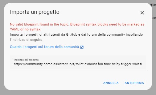

Hi, latest HA and everything updated
So I don’t understand the problem
Annotazione 2024-01-05 085445
I am not on the latest HA and I get this.
7
When HA release its next release I will update and see if it is a problem. Maybe it is a new version thing.
Blacky :smiley:
Thank you
I’ll wait to try
@sajikur
You could try to do it within HA. Go to settings / automations and scenes / blueprints tab / import blueprint and then paste this code in and preview.
https://gist.github.com/Blackshome/70349658a0c7543dbaa5f2e69e10cce0
It may work.
Blacky :smiley:
YEEEESSA
thank you
No problem… it is probably your browser. Good to know it is not HA and thanks for letting us know :+1:

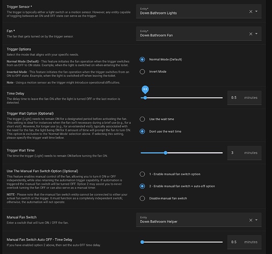

I tried adding the Helper as the Manual Fan Switch and turning on the actual fan switch does not seem to trigger the auto off. To be explicit here are my settings
Downstairs Bathroom lights is the switch that turns on the lights. Downstairs Bathroom Fan is the switch that turns on the fan. And Down Bathroom Helper is the Toggle Helper. In this case, turning on the fan using the Downstairs Bathroom Fan does not trigger the auto off.
@pinkchry
Just tested it here and all is working. Note your bathroom light must be OFF. You don’t turn the fan ON you turn the toggle helper ON. When you turn the toggle helper ON it will turn the fan ON and then OFF in the auto OFF time delay.
Blacky :smiley:
