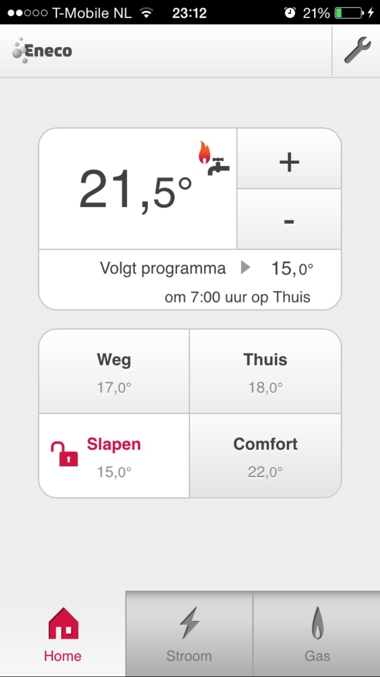

Another feature what would be awsome is see the if there is hot tapwater used.
Toon is visualizing it in his own display but should it be possible to view this is also in Home Assistant?
@kurniawan77 You could remove lines 43 to 54 in /sensor/toon.py to disable the sensor and both 18 and 19 in /switch/toon.py to remove the switch part. Let me know if it works.
@Imperial-Guard Where is you Toon displaying that? I don’t think mine has that functionality at all.
I think the physical Toon device sees if it has the burner on for heat. Then it displays the heating symbol. If it does not heat, but the burner is on, it must a water demand.
