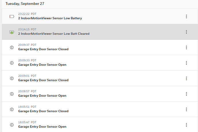

The sensor activities are enabled and I can see all of them in the web portal. BUT… this doesn’t seem to be reflected in Home Assistant.
Example, this is the activities page in TC:

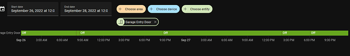

But in home assistant, nothing for that sensor.
So as I said, while Sensor Activities are enabled for each and every zone (for some reason I can’t enable the Motion View Cameras, but I can live with that)… this is not reflected in HA.
