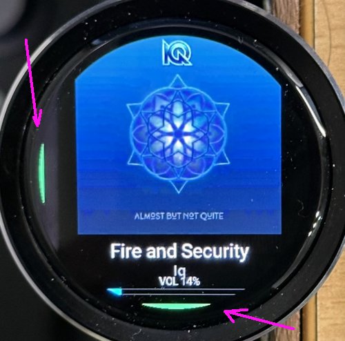

Just a question to the other people using this display… I loke it a lot but I can’t remove these kind of green light leaks (marked). Any ideas? Thanks

Seems that the offset in x- and y-direction is not matching your device.
You can modify it by using:
    dimensions:
      offset_height: 6
      offset_width: 6
https://esphome.io/components/display/mipi_spi/
