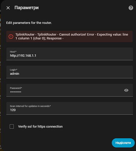

Hello everyone,
After updating the TP-Link Router
Hardware Version: Archer AX55 v1.0
to
Firmware Version: 1.4.1 Build 20250821 rel.70686(4555),
I lost the integration connection with the router.
As I understand it, they either closed the API, changed it, or replaced the authentication.
Because right now I have the following situation:
Verify ssl for https connection: checked or unchecked doesn’t matter, i’ve tried both options,
Is anyone else experiencing this?
log
custom_components.tplink_router.config_flow
custom_components/tplink_router/config_flow.py:87
TplinkRouter Integration Exception - TplinkRouter - TplinkRouter - Cannot authorize! Error - Expecting value: line 1 column 1 (char 0); Response -
for the local connection via UI - need JUST a password without the login
found the issue in Repo
