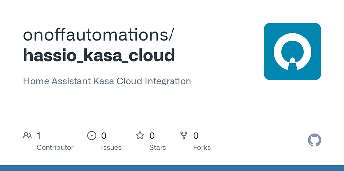

I have created a Kasa Cloud integration, it still has some bugs with some sensors, but the typical on/off switch is working very well
Enjoy it, and keep me posted on any issues
