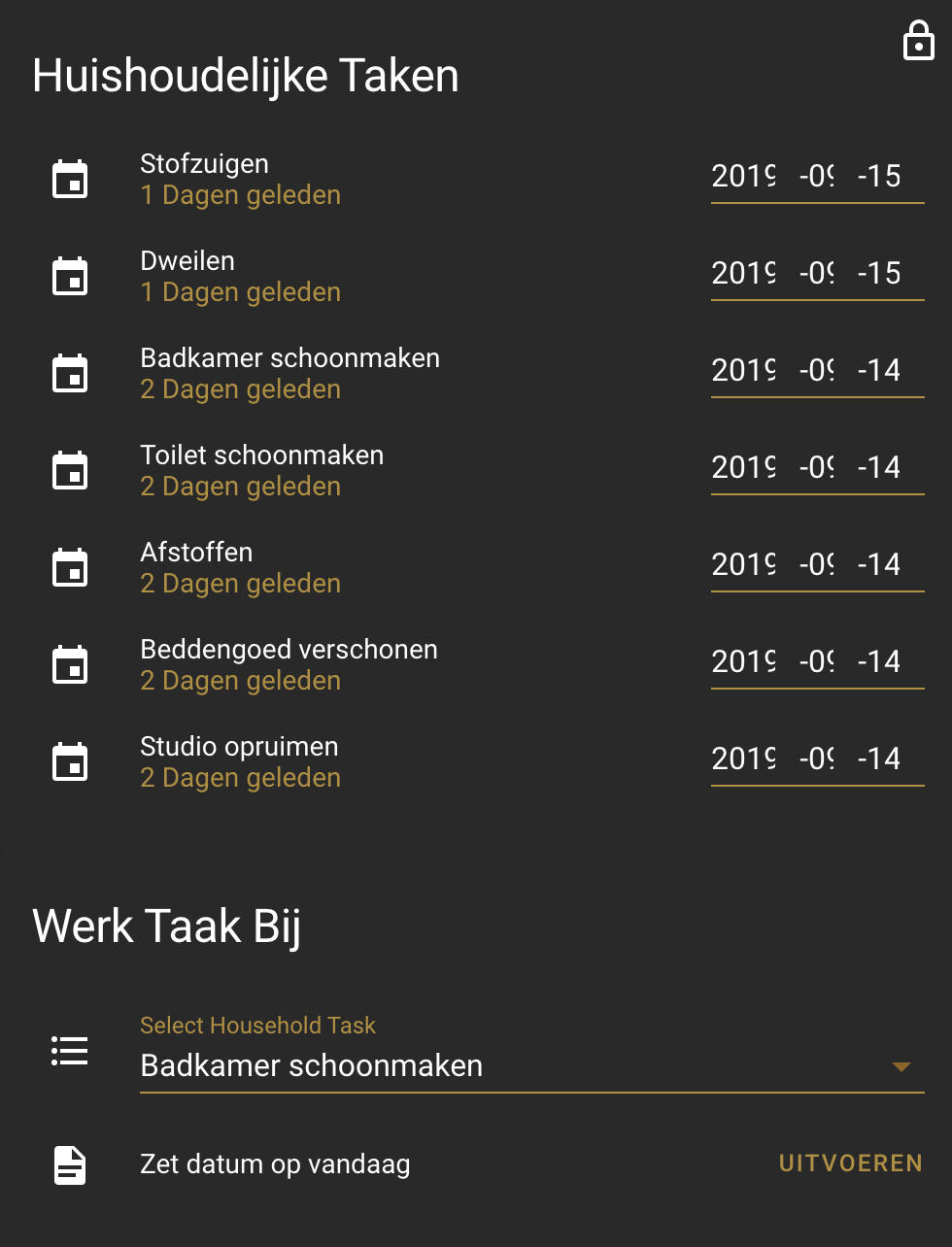

I have been living on my own as a student for a while now and have set a goal, to make my 25 square meter studio as smart as possible. If you have a house then you can’t escape it (okay there is a way out as a man :sweat_smile:), someday you’ll have to do something in the household if you want to live comfortably.
Last week I came up with the idea of integrating household tasks into Home Assistant, so that I get a notification if a task has been postponed for too long.
My Usecase
I want to be able to keep track in Home Assistant when a household task was last done, how many days ago and with a simple click I can change the date to today. This works with the main tasks that come back once a week or 2 weeks etc.
End result
The text in the photo below is mostly in Dutch
I have written all the information from beginning to end in a blog on my own website, you can also find references to my code on Github and some extra screenshots.

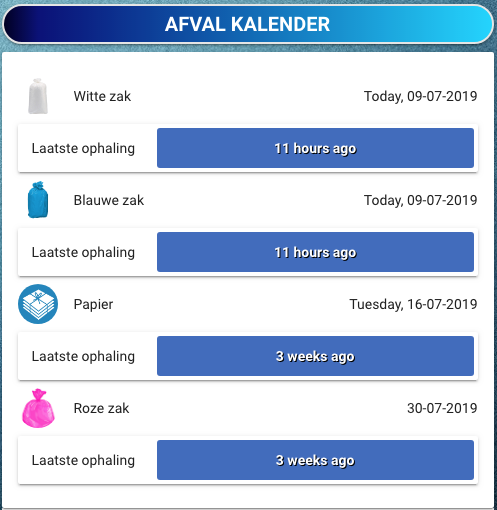

very nice project but I think this card is more suitable for what you are trying to do.
Example, I need to push the button when the task of putting the trash out has been done
Have not seen this card before. It’s indeed very similar to what I have been building, but I don’t think it really fits in with how I would like to see it in Home Assistant (but that’s my personal opinion).

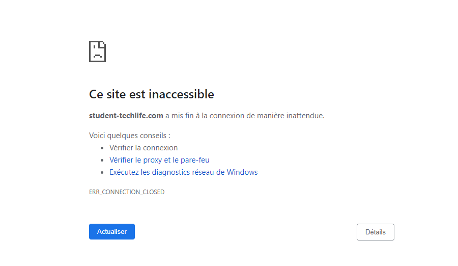

@klaasnicolaas, I wanted to check out your project, but was blocked by Google…
@Marc-Antoine_Seyer Thank you for letting me know! Strange that you received this message because there is an SSL certificate, but it must now be resolved :smiley:
@klaasnicolaas, hmmm… Seem like more work is required :wink:
The message is in french, but it says that the website is not accessible.
Strange. The website just works for me, writing a new blog last night. What if you approached the website in incognito mode?

It work now ! Nice
Unfortunately my card doesn’t look so nice… And is it possible to change the date format to DD-MM-YYYY?
