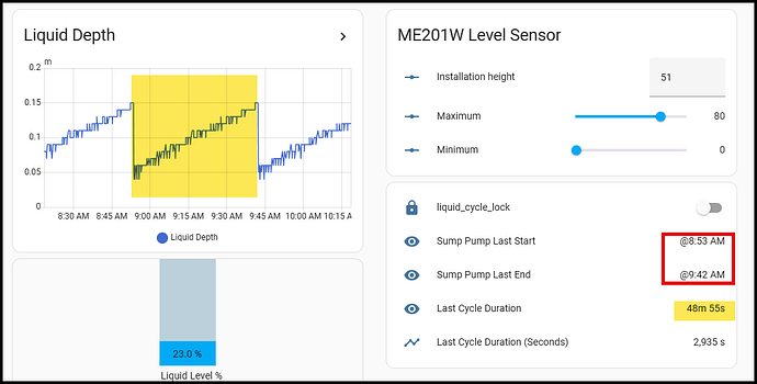

I have recently taken a slightly different approach and instead of trying to fully track the operation of the pump electrically I put a sensor to measure the depth of the water in my sump pit. This allows me to track the rate of the water entering the pit and can start to correlate with my weather if I wish (future). Here is the setup I have to track the water depth and the sensors for the time the sump has run. From this I can setup various alerts, but ultimately I need to setup how to manage when the power is out (generator vs UPS). I am planning to install a venturi pump to use city water to manage the depth with a setting higher than the electrc controls. This can be costly depending on the ratio of pit water to city water during the storm, but cheaper than a flooded basement.
