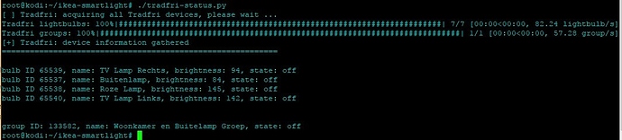

I have the same problem as dylanmurphy.
I tried the setup explained in https://learn.pimoroni.com/tutorial/sandyj/controlling-ikea-tradfri-lights-from-your-pi
that works perfectly.
This also tells me that the IP and the security code is valid of the tradfri hub I used in the HA config. I can controll my Receiver and Chromecast with Home assistant so the HA setup is working either.
Firmware level of the hub is 1.1.0015.
Any thoughts?
