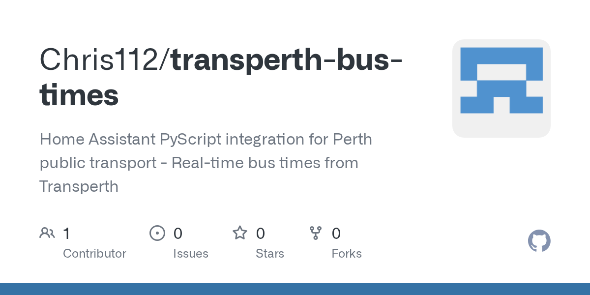

I’ve been messing around with the Transperth live bus time APIs to try and see if the information is available and it looks like most of it is, here’s a breakdown of what I did to load the data. It requires a bit more work than the trains.
I created a python service you can add to HA and call within some kind of automation to load bus stops by bus number or next bus times at a bus stop
