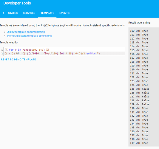

So tomorrow I’ll try the following in order to achieve less “granularity” and avoid holes in the sequence of values {{ ((states ('sensor.heater_kwh_today') | float*200)|int % 25) >0 }}
In practice I reduced the values to a fifth of the original and cut off decimals
Genuinely interested what the trigger values are. By my testing, your template should trigger for any state update except a multiple of 125Wh and 4Wh after that multiple:

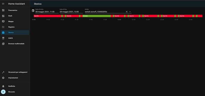

Every time is triggered the pump switch on for 1 min twice, separated by a 1 min delay.
As you can see it seems all fine except for that time in which te pump doesn’t switch off.
I need to investigate further.
That’s probably related to the period when the template in my example is returning false.
If you compare the switch operation against the value of sensor.heater_kwh_today, you’ll probably find it’s triggering every time there is an update, regardless of value except at or shortly after a 125Wh increment.
