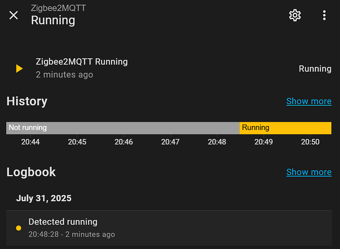

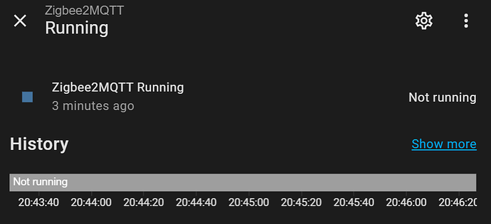

Z2M running binary sensor is working, at least for me. I tested this for you by stopping the Z2M addon manually. Took a couple of minutes to update, but I can indeed see the state change.
Something is weird with the logbook and history though. I’m assuming these are somehow excluded from the recorder, but once I switched it off, I could see the timeline shrink to every 20s with no prior history.
Once I switched it back on, I could see the previous state and the current state in the timeline
