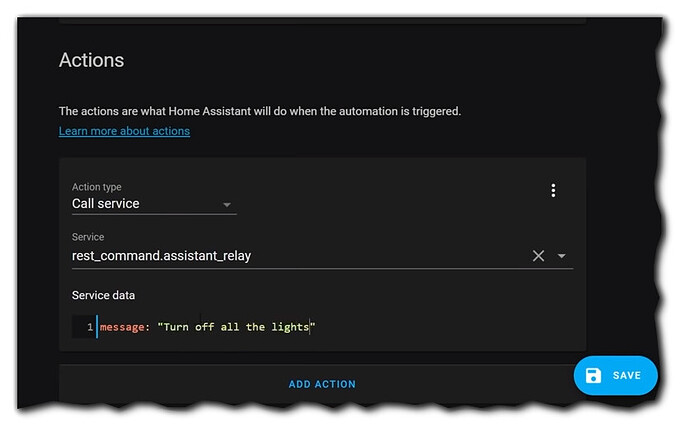

I believe you need to click on “ZUM YAML MODUS” and add the message just as he does in the video
I also tried that. In the video he’s is not using the YAML-mode. This is a screenshot of his video:
Nevertheless I tried it with the YAML-mode and got this error when saving the automation:
Try
- service: rest_command.assistant_relay
    message: "message text"
Well, he using a different version of HA where it looks different.
I’m having a similar issue, UI for service data doesn’t display for my POST rest_command.
