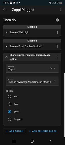

Just need to puzzle how to use the an Automation to change the Mode.
SUSSED IT
In Actions - select Call Service and start typing myenergi and the Modes will pop up.
To change Mode Fast-Eco-Eco±Stop select Device then Zappi, choose action and select your choice.
