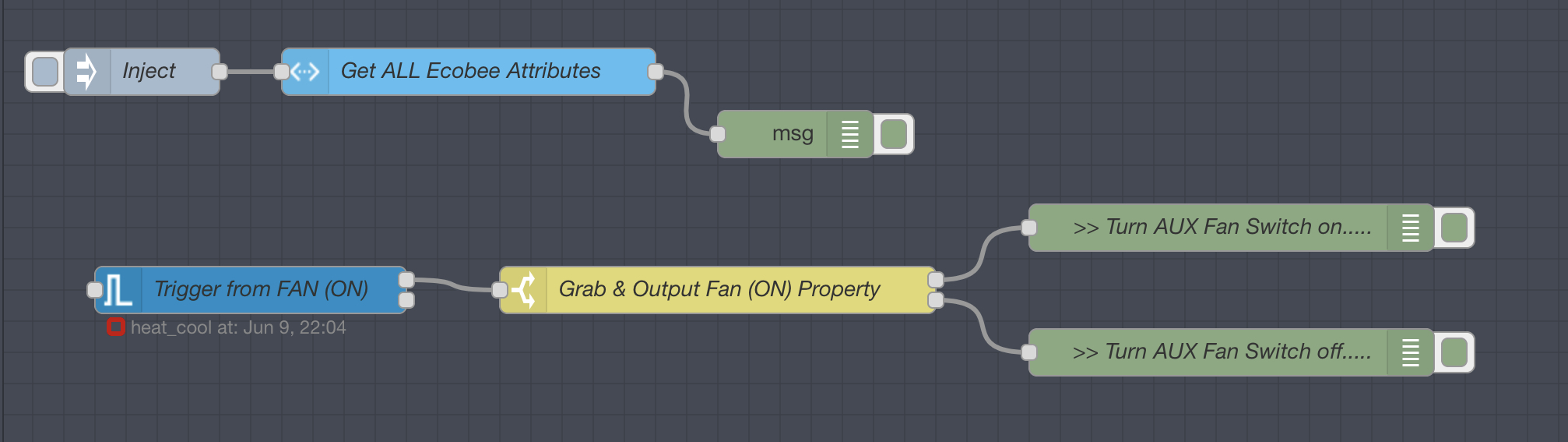

Well, in that case… this’ll help. Just change the Entity to your climate.ecobee name
The top sequence will output all your ecobee property attributes into a debug node. So you can use that to get property names, and trigger other events etc. (if you need help getting the attribute path (eg, * data.attributes.fan*) just let me know)
The other sequence just triggers when the fan turns on
When you just Poll the climate.ecobee it’ll just tell you its current HAVC mode. You need to specify its property attribute specifically
Heres the Node-Red flow import:

EDIT: connect the “blocked” output from the trigger to the switch too. Otherwise it wont send “off” outputs

Sorry, that’s completely my fault (I should’ve tested it first). The trigger state node wont pass msg.data.attribute.fan. Heres a Poll (as you originally wanted) that will.
I try and avoid Polls running 24/7, but if you’re adding this to an existing flow, you could trigger it with a current state node and then add the switch after that.
But if you just want this to be looking for the fan to be on (every 60s) then this flow will work,
[{"id":"66093b3b.9510f4","type":"switch","z":"708e6065.155a58","name":"Grab & Output Fan (ON) Property","property":"data.attributes.fan","propertyType":"msg","rules":[{"t":"eq","v":"on","vt":"str"},{"t":"else"}],"checkall":"true","repair":false,"outputs":2,"x":480,"y":300,"wires":[["9f00daf2.e4acb"],["652c0620.9fc4b8"]]},{"id":"9f00daf2.e4acb","type":"debug","z":"708e6065.155a58","name":">> Turn AUX Fan Switch on.....","active":true,"tosidebar":true,"console":false,"tostatus":false,"complete":"payload","targetType":"msg","x":810,"y":260,"wires":[]},{"id":"55a5a3a9.4c1acc","type":"poll-state","z":"708e6065.155a58","name":"Poll Ecobee Thermostat (60s)","server":"41c2e4cc.1954cc","version":1,"exposeToHomeAssistant":false,"haConfig":[{"property":"name","value":""},{"property":"icon","value":""}],"updateinterval":"60","updateIntervalUnits":"seconds","outputinitially":true,"outputonchanged":true,"entity_id":"climate.home","state_type":"str","halt_if":"","halt_if_type":"str","halt_if_compare":"is","outputs":1,"x":180,"y":300,"wires":[["66093b3b.9510f4"]]},{"id":"652c0620.9fc4b8","type":"debug","z":"708e6065.155a58","name":">> Otherwise...","active":true,"tosidebar":true,"console":false,"tostatus":false,"complete":"payload","targetType":"msg","x":760,"y":320,"wires":[]},{"id":"41c2e4cc.1954cc","type":"server","z":"","name":"Home Assistant","legacy":false,"addon":true,"rejectUnauthorizedCerts":true,"ha_boolean":"y|yes|true|on|home|open","connectionDelay":true,"cacheJson":true}]
Keep in mind, the msg.payload will still be the current HVAC mode (eg, heat_cool, “cool”, “heat”) after the switch; but the switch will only allow the payload to continue if it detects msg.data.attributes.fan = on. Otherwise it spits out the payload to “otherwise” (aka. off). So you may need a change node payload after the switch; something like “set msg.payload to on” depending on how you flow goes.
Heres the flow with the change nodes…
[{"id":"66093b3b.9510f4","type":"switch","z":"708e6065.155a58","name":"Grab & Output Fan (ON) Property","property":"data.attributes.fan","propertyType":"msg","rules":[{"t":"eq","v":"on","vt":"str"},{"t":"else"}],"checkall":"true","repair":false,"outputs":2,"x":480,"y":300,"wires":[["f0e498b1.8a9aa"],["9abb5a94.d98f4"]]},{"id":"55a5a3a9.4c1acc","type":"poll-state","z":"708e6065.155a58","name":"Poll Ecobee Thermostat (60s)","server":"41c2e4cc.1954cc","version":1,"exposeToHomeAssistant":false,"haConfig":[{"property":"name","value":""},{"property":"icon","value":""}],"updateinterval":"60","updateIntervalUnits":"seconds","outputinitially":true,"outputonchanged":true,"entity_id":"climate.home","state_type":"str","halt_if":"","halt_if_type":"str","halt_if_compare":"is","outputs":1,"x":180,"y":300,"wires":[["66093b3b.9510f4"]]},{"id":"f0e498b1.8a9aa","type":"change","z":"708e6065.155a58","name":"Msg.payload >> on","rules":[{"t":"set","p":"payload","pt":"msg","to":"on","tot":"str"}],"action":"","property":"","from":"","to":"","reg":false,"x":730,"y":260,"wires":[[]]},{"id":"9abb5a94.d98f4","type":"change","z":"708e6065.155a58","name":"Msg.payload >> off","rules":[{"t":"set","p":"payload","pt":"msg","to":"off","tot":"str"}],"action":"","property":"","from":"","to":"","reg":false,"x":730,"y":340,"wires":[[]]},{"id":"41c2e4cc.1954cc","type":"server","z":"","name":"Home Assistant","legacy":false,"addon":true,"rejectUnauthorizedCerts":true,"ha_boolean":"y|yes|true|on|home|open","connectionDelay":true,"cacheJson":true}]
And if you want the specific property path for anything, run the inject node, and look here. This button will copy the attribute path.
