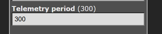

Have you checked the MQTT broker before accusing HA?
Use MQTT Explorer to see what is happening on the broker.
TelePeriod See current value and force publish STATE and SENSOR message
0 = disable telemetry messages
1 = reset telemetry period to firmware default (TELE_PERIOD)
10..3600 = set telemetry period in seconds (default = 300)
What he said ^^
Default telemetry period in Tasmota is 5 minutes. If you haven’t changed it then it’s gonna report every 5 minutes
Thank you,
I learned a lot.
As a newby to Tasmota I didn’t know that there are possibilities to configure beside the GUI
