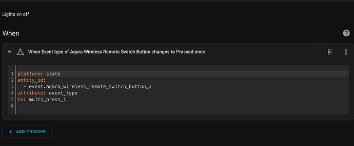

So setting up a simple automation trigger like the below I assumed this would work.
Unfortunately, it did not trigger every time… not so simple. So after a bit of investigation I can see the device state will always be maintained. So the automation does trigger If the prior state is different. So if I change the state by say doing a double press first, followed by a a single press the automation triggers. Ok I thought, the automation needs a state change or I need a trigger that works on repeat events.

Figured it out. Sharing for anyone else that might have a similar question in the future. Pretty basic, should have caught it sooner.
Got it working eventually using Event triggers but in reality the key was having an “and if” condition related to the specific state.
In short, you trigger is based on the entity state change, if a specific state is recorded. In this case “multi_press_1” for a single press. See image. Hopefully, this might save others some time
