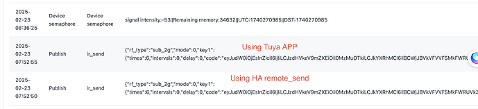

  1. Extracted the working Base64-encoded RF codes from the Tuya IoT Device logs and added them to HA using the localtuya.add_remote_code action.
  2. Verified that Device sends the correct RF signals (remote.send_command), as confirmed in the Tuya IoT debug logs(identical to what the Tuya app sends) , when triggered by HA
