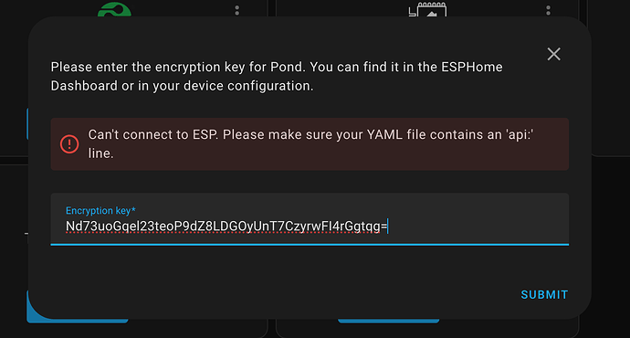

Now it seems to be discovered on ESPHome, however I’m not able to configure it. I get the error: “Can’t connect to ESP. Please make sure your YAML file contains an ‘api:’ line.”

esphome:
  friendly_name: PondSwitch
esp32:
  board: esp32dev
  framework:
    type: arduino
# Enable logging
logger:
# Enable Home Assistant API
api:
  encryption:
    key: "Nd73uoGqel23teoP9dZ8LDGOyUnT7CzyrwFI4rGgtqg="
ota:
  password: "e08da02f6560338f57fc0e4d19d21cb8"
wifi:
  ssid: !secret wifi_ssid
  manual_ip:
    static_ip: 192.168.20.88
    gateway: 192.168.20.1
    subnet: 255.255.255.0
  ap:
    ssid: "Pondswitch Fallback Hotspot"
    password: "guNgvPbvlMc1"
captive_portal:
