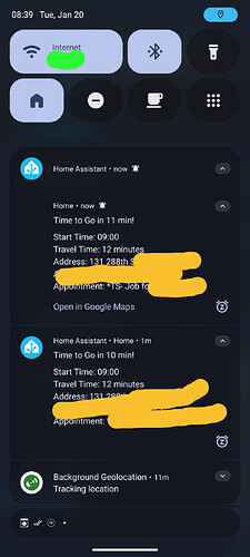

I made a script to make it easier and more consistent to generate notifications. It exposes a bunch of the options through fields. Generally that works, but I’m having issues passing an action to the script. I can’t figure out how to format the action data so it’s passed correctly to the script.
This first notification is the goal, however the second is what I’m getting when I try to pass the same data through a script using fields.

This however doesn’t work (there is no “open map”) on the notification.

Here’s the trace info from the second notification:
Executed: January 20, 2026 at 08:38:00
Result:
params:
  domain: notify
  service: mobile_app_a
  service_data:
      importance: high
      priority: high
      subject: ''
      sticky: false
      persistent: false
      timeout: ''
      color: yellow
      tag: leave_time
      channel: Leave Time
      visibility: public
      notification_icon: mdi:car-arrow-right
      clickAction: ''
      alert_once: false
      actions: |-
        - action: URI
          title: Open in Google Maps
          uri: https://www.google.com/maps/dir/?api=1&destination 131+288th
      notification_id: ''
    message: >-
      Start Time: 09:00<br> Travel Time: 12 minutes <br> Address: 131 <br> Appointment: *TS- Job
      for A
    title: Time to Go in 10 min!
  target: {}
running_script: false
I did try using a few variations both on the script configuration and call side.
>- for example, and the editor seemed to tweak how it’s saved.
That’s not valid… actions should contain a list of action objects, not a list-shaped string.
Thanks for taking a look. That was the hint I needed.
The GUI was putting that into the YAML and I didn’t notice it when I pasted it on here. Not the first time the GUI has stumbled me with templates.
I changed the YAML to this and it works now.

    states('sensor.next_location_summary') }}
  title: >-
    Time to Go in {{
    states('sensor.countdown_to_next_departure_calendar') }}!
  actions:
    - action: URI
      uri: >-
        {{states('sensor.next_location')       | replace('  ', '+') |
        replace(' ', '+') }}
enabled: true
