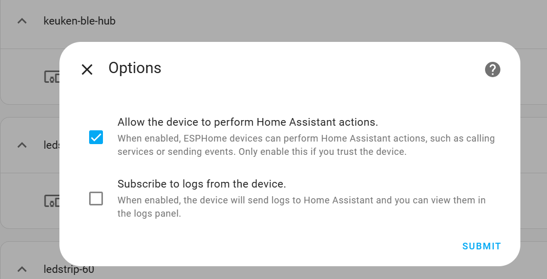

Did you enabled the Home Assistant action switch for this device, it’s by default disabled.
Hello, yes I forgot to mention that I did enable this setting.
