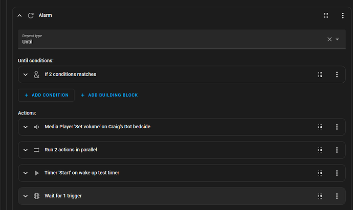

hey all,
i have set up an extremely over complicated alarm system as i am terrible at getting up :stuck_out_tongue:
i have a repeat to send Alexa notifications and then a delay to wait before resending them, of course this means if i restart home assistant it gets cancelled in its tracks - so i have managed to set up a timer system for it to start a timer wait for it to complete and then continue the repeat
i thought since timers survive restarts if i reset home assistant midway through the delay timer it would have no issue pausing the timer and then when its all restarted continuing the timer and continuing the alarm (or at least being re-triggered by a state change from active to idle) but everything i do just does not survive a reboot
its only a 10 second delay and i had thought having a restore timer would pause it and then resume it on reboot but after watching a test 5 minute timer it just keeps ticking so i think that could be an issue?
any help would be appreciated - i will post the yaml if anyone needs it but lie i said its extremely over complicated so it may just be a big mess
(i do have a very simple workaround of just retriggering when home assistant boots but i would like to know if i can do it this way or at least understand why it isnt working)
We can better help if we see the yaml code instead of a screenshot of the UI.
here

Does that look right to you?
i noticed that but i had copy pasted it from another user so i knew it looked wrtong but wasn,t sure
it looks fine in the visual editor which is what i mainly use
doesn’t seem to have changed it still doesn’t to anything on boot
As posted above, with a literal backslash character and letter tee, it corrupts the event’s name.
My understanding is that you probably had a literal tab character and, during the copy-paste operation, it was represented as \t. It exists within the double-quotes so it’s interpreted as part of the entire string (thereby defining a non-existent event name).
Ensure the timer’s restore option is enabled and you understand how it causes an active timer to behave after being interrupted (notably its finished_at property).
If an interrupted active timer fails to automatically resume its remaining countdown after a restart, then you may need to report it as an Issue in Home Assistant’s Github Core repository. In fact, there appears to be an existing open Issue about a failure to resume.
i removed the backslash and cleaned it up to be identical to the .finished trigger (which does work fine) and it still does nothing, and the timer is selected to restore, i dont know much about timers and at a glance through the wiki and such i cant find anything helping me out so that’s why I’m asking here,
i may be missing something with how the timer works or how the automation is set up all i know is that a 5 minute timer does continue after restart but the 10 second one wont so it wont retrigger the alarm when home assistant starts up and I’m unsure why or any ways to work around this to get the automation to restart using a timer after i reboot home assistant
