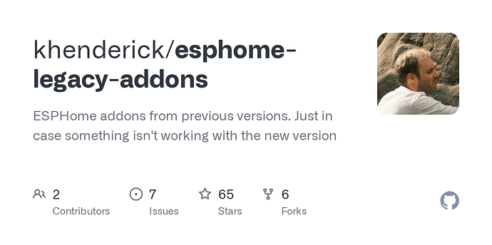

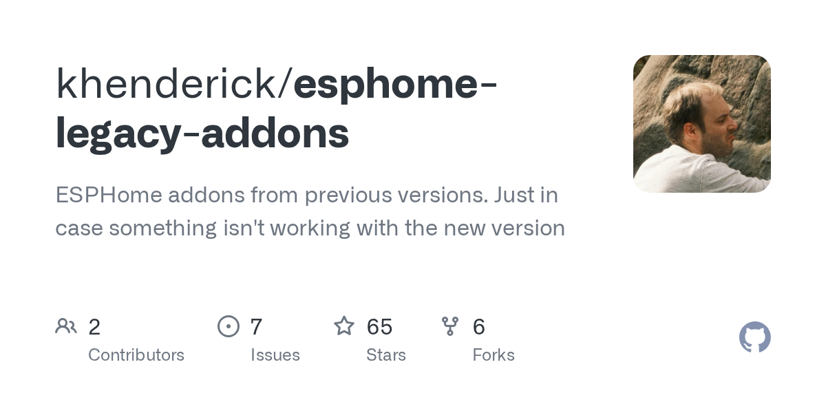

Try rolling back, does that fix it? If so - log a ticket on Github.
If you need to roll back to a previous ESPHome version, add this repository to your add-ons apps:
It will let you compile with previous ESPHome versions. That may solve your issue while you search for root cause.
@zoogara - Thanks! I didn’t know how to roll back to older versions like that.
I have verified that I can get it working with ESPHome 2025.11, so definitely looks like something that was introduced in a recent update. I’m running on an HA Green (so build takes a while), so I haven’t stepped through to figure out exactly which update breaks this for me.
