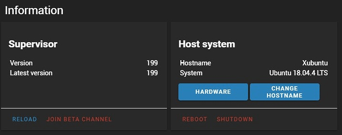

If you are running Home Assistant Supervised (Hassio) You CANNOT do a docker pull to update. You must update via the Supervisor Side panel (hassio side panel) OR use ssh to update… (and unless you are on HA-Supervised/Hassio there is no such thing as a snapshot)
This is my system…
… so, How I can update?
There should be an update button on the dashboard. (You are showing the system tab)
Or use the ssh addon…
