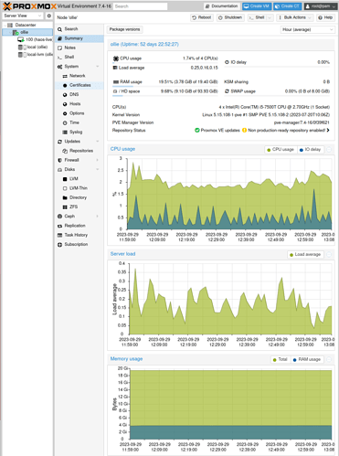

I personally upgraded my HAOS with Rhasspy (voice assistant), MQTT, zigbee, LocalTuya, node-RED but only 23 devices … from a RasPi 4 to a VM under Proxmox on a used business SFF PC. It gave a noticable performance boost to the local voice assistant, but as you can see it is using only a tiny fraction of the machine.
