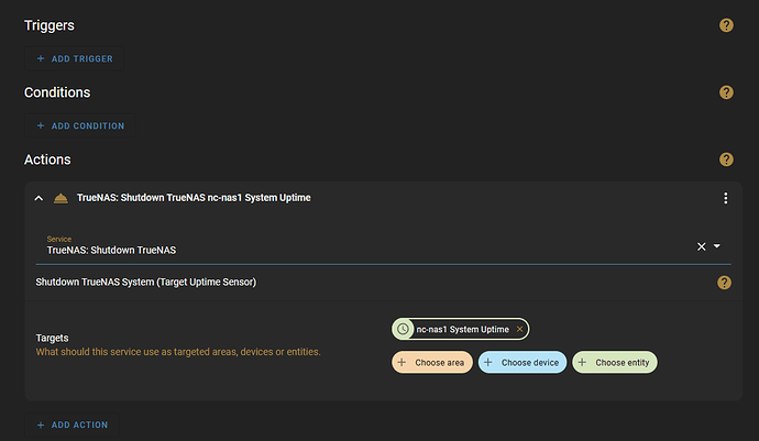

(shutdown from up above comment) How do I do it though, I just tried it from the Developer tools and nothing happened. Tried calling TrueNAS shutdown with the TrueNAS System device selected, felt about right. I suspect this should have done something and just did not.
‘service: truenas.system_shutdown
data: {}
device_id: xxxxxxxxxxxxxxxxxxxxxxxxxxxxxxxxxxxxxxx’
You have to use uptime sensor as target. See documentation on github.
Thanks Tomaae, Sorry I didn’t understand that line when I first read it. Get it now though…
no problem. but its better to ask technical questions on github, you get faster answer.
Can you post what you did?
The documentation isn’t very clear on this and i’m struggling to implement shutdown in Truenas Scale.
Any help would be greatly appreciated.
Thanks
Not sure what is unclear about it, you just have to target uptime sensor:
Ah this helped.
Thank you!
