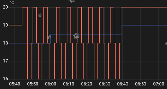

I hope it’s ok if I get out this old Thread again :slight_smile: I have a little problem, my TRV gets calibrated but it is a bit repetitive and it makes no sense:
I am definitely too stupid to understand the code. My TRV can only show 1.0 steps in current_temperature and in target temperature - is it because of that?
How long should the delay be? I set it to 1 Minute in the screenshot.
Thank you!
