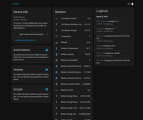

Just made my first HACS integration. Today I made the first (what I think) is stable release, but it’s not been tested out in public yet.
Feel free to dive into the world of OVMS (if you own one). If not, maybe try my integration anyway. :smiley:

I installed it and connected to the server, but there appears only one entity ovms_VEHICLEID_status, no more data.
When opening MQTT explorer, there only seems to be this entity:
Do I have to change configuration at the OVMS server first?
*Update: seems like it is a setting in the OVMS hardware. I will check this soon and keep you updated.
Hi, thanks for the feedback!
You probably spelled the vehicle_id wrong. I’ve done the same thing many times during testing. It’s trying to parse the vehicle_id, and sometimes it gets it wrong.
Like it’s hard to notice the difference between l and I (small L, large i). :slight_smile:

Hey guys (and girls), just released 0.8.0. Improved frontend in this one, and the setup is now perfect (according to me).
Try it out, create issues, and post feature requests!
