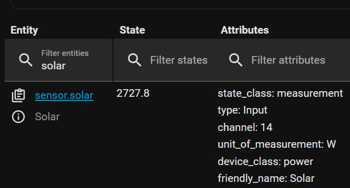

I’m watching this tutorial: Mastering Home Assistant Templates: A Beginner’s Guide at about the 8:50 point it gives the following example: {{ state_attr(light.desk_backlight’,‘energy’)}} with the result being 69.79. I tried to implement something like this in the Template editor for my system to try it out. I typed: {{ state_attr(‘sensor.solar’,‘power’)}} but the result I got was null and Result type:dict When I go into Developer tools this is what I see:
You don’t have an attribute called power. 2727.8 is the sensor’s state.
The list of attributes is on the right.

I tried your suggestion, and before I could type in the “| float(0)” it already gave me the desired result. Your comment not having an attribute called power. I believe you, but in the jpg I included, under the attribute column, I do see “device_class: power”. I guess I assumed incorrectly that “power” was an attribute. Still trying to wrap my head around this stuff. Thanks for your guidance!
