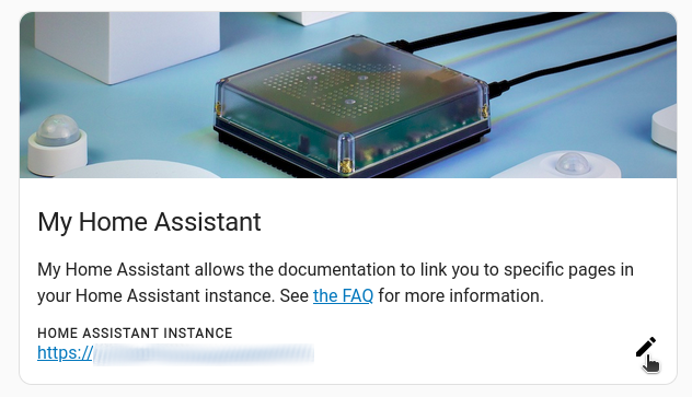

Go to https://my.home-assistant.io/ and make sure it has the correct IP for your HA Green.

sorry but when I click on that it tried to connect using http://homeassistant.local:8123/
which doesn’t work. I can only connect using the IP address.
when Iupdate the IP address it does work thanks!
Is there a way so I can use http://homeassistant.local:8123/ . Can I change this in a setting?
Sorry I am really new to this there is so much to learn!
Thanks
Martin
The link I provided should lead to a page like the following, with an pencil-shaped edit button that will allow you to change the address that is currently set to whatever address you need to use:

Thanks but it does not work. I pasted in http://homeassistant.local:8123
But when I use it, I still get:
This site can’t be reached
homeassistant.local’s DNS address could not be found. Diagnosing the problem.
DNS_PROBE_POSSIBLE
Why would you paste in an address that you can’t connect to? Use the address that actually works.

Sorry I thought the link would allow me to change the address to the default.
My bad
I still do not understand why http://homeassistant.local:8123 has suddenly stopped working and I have to now use an IP address?
But thank you you have now sorted the Blueprint import issue, I can now bring those in!
