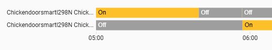

This morning i was surprised to see that my chicken door wasnt open all the way and was stuck in the middle…so i was wondering how to make an alert notification that watches my “is open” or “is closed” status that i have available and when one or the other changes, wait 20 or 30 seconds and if the other status hasn’t changed after that throw an alert for either did not open or did not close…
I tried a couple versions, but somehow i dont get the logic in to read both status, plug it into a variable, use the on the one that is “on” (for open or closed) dynamically and as soon the “on” changes to off, wait 30 seconds and when the other on reaches "on in that time frame do nothing, but when it does not reach the “on”, throw an alert that uses the variable to tell if it either did not reach open or closed in time.
