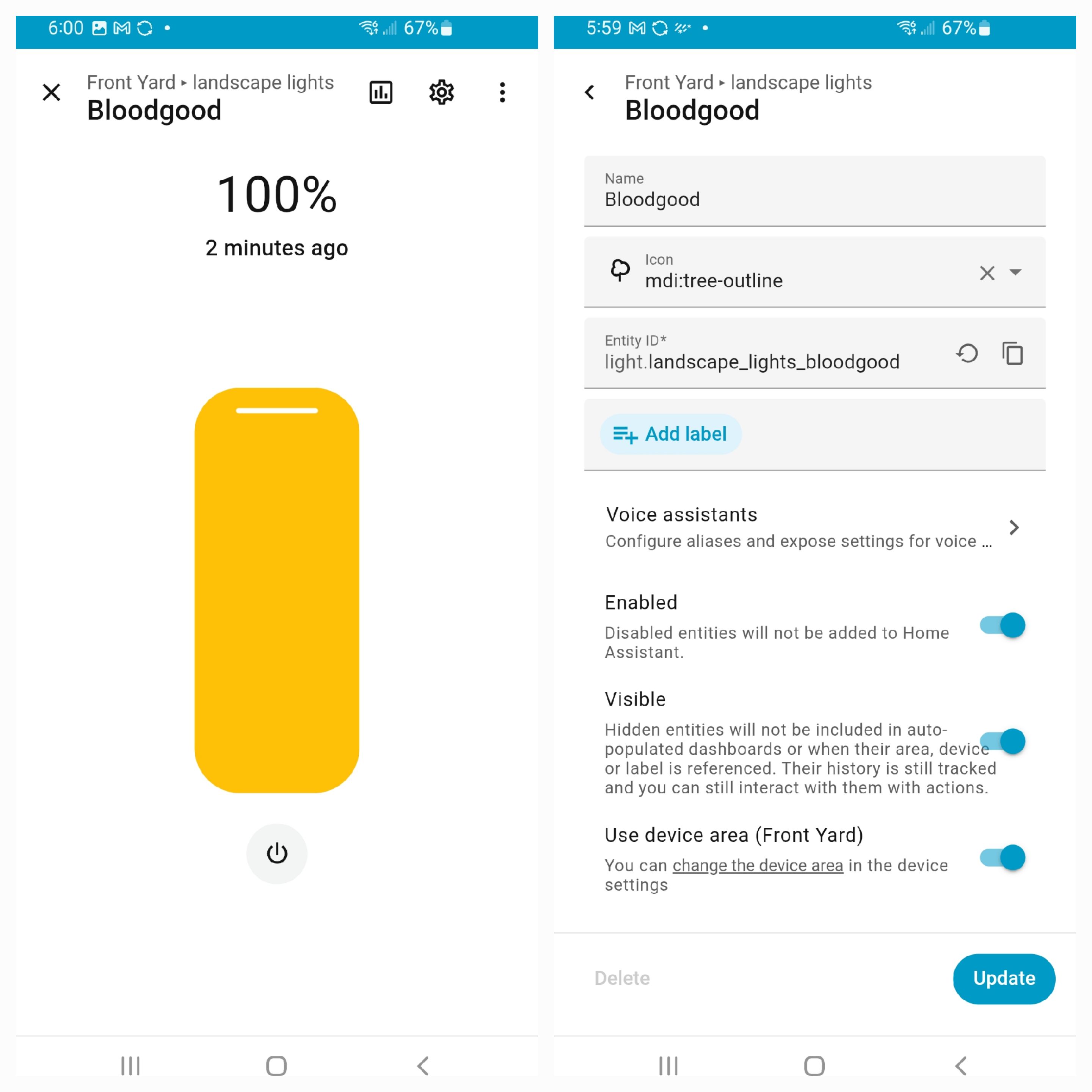

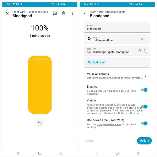

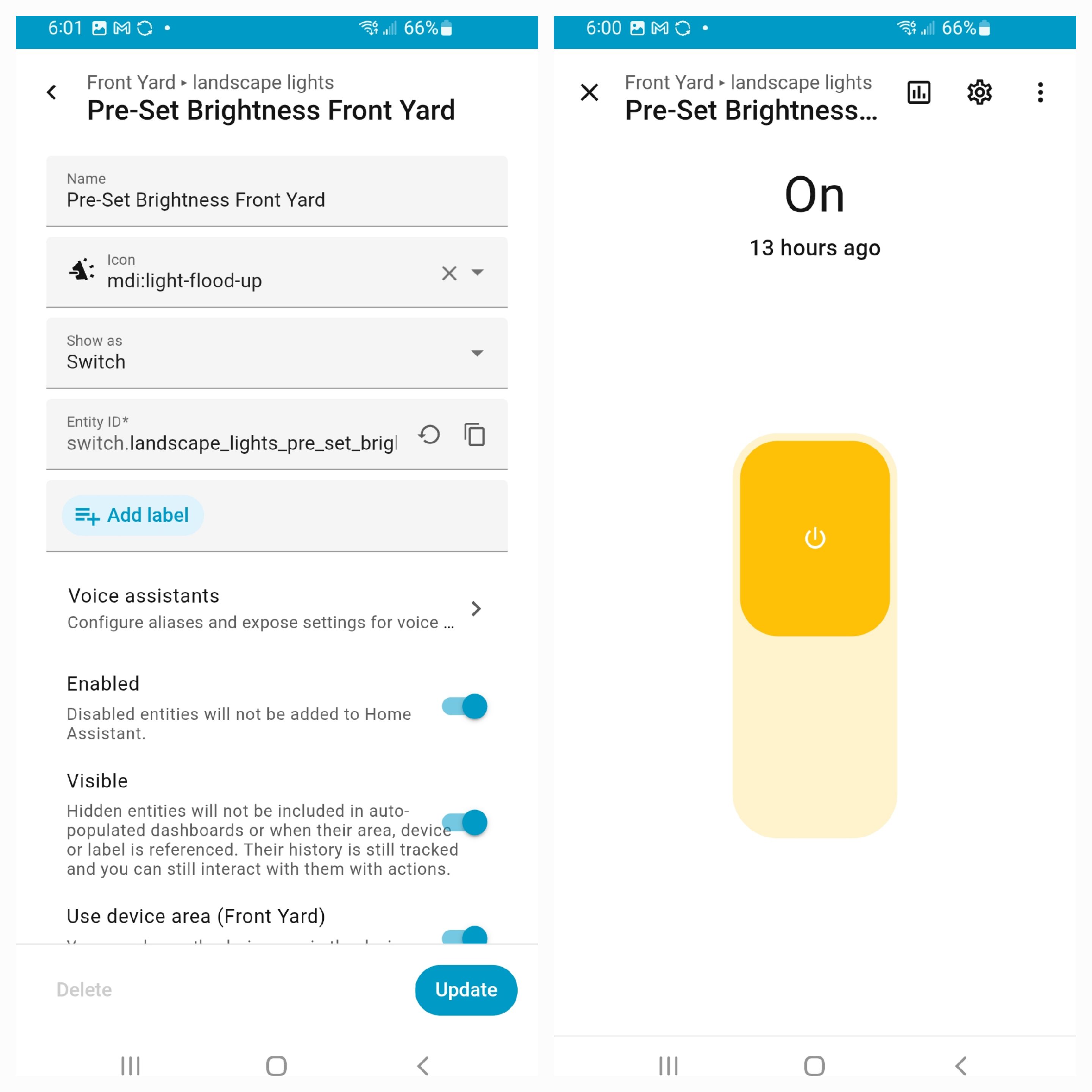

Say what?? No, that is for starters incorrect and secondly, it goes completely against all logic and common sense. When configured using Output and Light, it by default creates a Light entity in HA that works exactly like a Switch would where both have a toggle On/Off. The reason it makes no sense to actually configure it as a Switch is for 1 thing, it doesn’t change anything in HA except it was a Light class and now its a Switch class and by making it into a Switch you’ve lost the one huge benefit of using an led, you cant use a Switch to Dim anything but, you could have used the original Light entity for both toggle On/Off and to Dim as long as no one follows that backwards piece lf illogical advice you gave…
IdK even know how it is even possible to even think you should use a “Switch” to control an led “Light” because the reason there is a Light integration in Esphome is for configuring a LIGHT.
Maybe an example will make my point easier to understand. Here’s the correct way to configure any led/light in esphome and notice both On/Off toggle and a Slider to control brightness…
Now here is a Switch. Notice what’s missing from the Switch platform?? I think maybe you should take some time to read through your own Reading Assignments and actually use and work with different configuration setups to better understand what it is your telling people they should do, especially if you’re giving them bad instructions and just making things even harder for them
