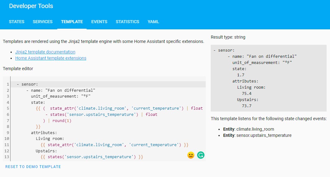

Cool so I got this far in the template builder in dev tools and it seems to be working but when I put it into the yaml using studio code server is lights up like a christmas tree with errors. What am I missing? Code snippet is below:
