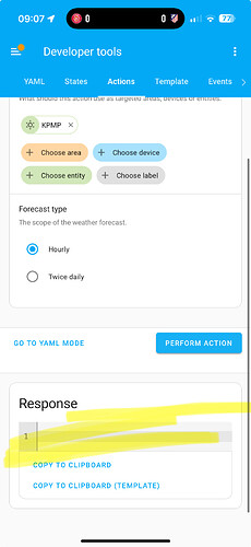

For some odd reason, I cannot execute an action it would retrieve the attribute for precipitation probability.
And I execute the action to get the weather forecast nothing is returned, even though the action appears to run properly.
Additionally, the sensor seems to be working at home assistant. Any ideas or thoughts on what I am missing?
