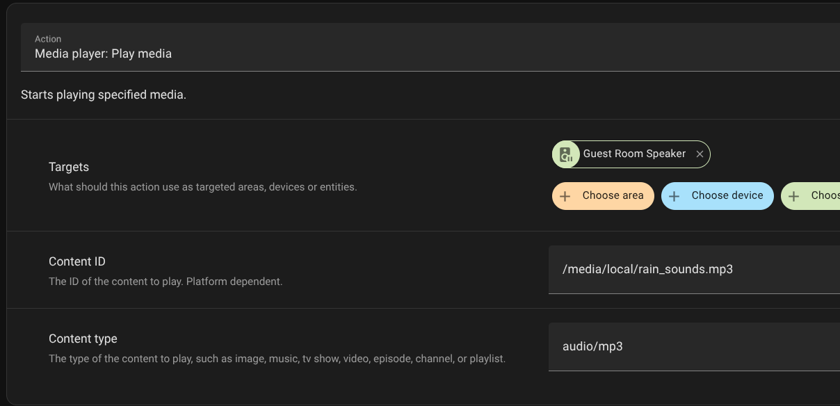

Trying to play a media file to google home, what am i missing?

I was able to get this working, however my approach differs slightly from the previous solutions.
Backstory: Similar to the original poster, I was trying to play media to a Google Home speaker. Initially I was simply using the “Play Media” action. Text-to-speech was working, so I tried playing a .mp3 file that I could find in “Local Media” of the “Cast” dialog. However, this failed to play out of the Google Home, and stopped the Automation from continuing.
More information about my setup: I use Home Assistant running in a Docker container inside my QNAP NAS via Container Station. To make mp3’s available in the “Local Media”, I created a docker bind from a folder in my NAS (/Container/volumes/home-assistant/qnap/), to /media/qnap/ in the docker container. Now anything I add to the NAS folder appears in HA’s “Local Media”. After reading the posts above, I tried messing with different solutions, but none worked for me.
Solution: Ultimately what I did was looked at the YAML for the non-working “Play Media” action. It exposes the required media_content_id and media_content_type based on the file I selected from the dialog browser.

One major difference from the posts above is that this use a media-source:// protocol prefix, and uses audio/mpeg instead of audio/mp3 as the protocol, however, I switched this to audio/mp3 for testing purposes and it still worked :+1:
Now I just plopped those values into a “Call Service” action and it worked on the first try!
Working Call Service YAML:
service: media_player.play_media
  media_content_id: media-source://media_source/local/qnap/alerts/alert1.mp3
  media_content_type: audio/mpeg
  entity_id: media_player.office_speaker

I was able to make this work with a combination of information given in this thread. For those not using Node Red this is what I ended up with. Local and Media are switched. The original poster should really mark a post as solved for future readers.
I can confirm it worked like this:
action: media_player.play_media
  entity_id:
    - media_player.googlehome_buero
  media:
    media_content_id: /local/SamsungWaschmaschine1.mp3
    media_content_type: audio/mp3
    metadata:
      navigateIds:
        - media_content_type: ""
          media_content_id: __MANUAL_ENTRY__
      browse_entity_id: media_player.googlehome_buero
With the mp3 file available at https://192.168.1.100:8123/local/SamsungWaschmaschine1.mp3, checked via browser.
