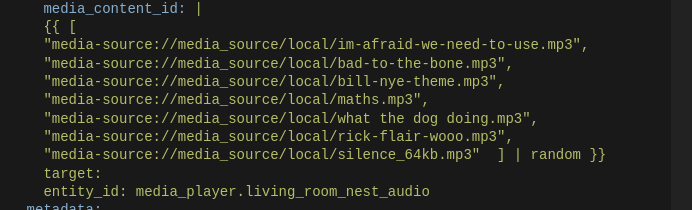

I am trying to play one mp3 file at random as part of an automation of unlocking the front door. This is what I have as my action:
service: media_player.play_media
      media_content_type: music
      media_content_id: |
      "media-source://media_source/local/im-afraid-we-need-to-use.mp3",
      "media-source://media_source/local/bad-to-the-bone.mp3",
      "media-source://media_source/local/bill-nye-theme.mp3",
      "media-source://media_source/local/maths.mp3",
      "media-source://media_source/local/what the dog doing.mp3",
      "media-source://media_source/local/rick-flair-wooo.mp3",
      "media-source://media_source/local/silence_64kb.mp3"  ] | random }}
      entity_id: media_player.living_room_nest_audio
    metadata:
      title: Random.mp3
      thumbnail: null
      media_class: music
      children_media_class: null
      navigateIds:
        - media_content_type: app
          media_content_id: media-source://media_source
And I keep getting an error at the end with the random piece. Specifically ] | random }}
Error in parsing YAML: missed comma between flow collection entries (line: 38, column: 62)
Not seeing what im missing
Hello franksantoro,
Notice how target: is still yellow in your posted code?
That tells me you have a formatting error. The pipe symbol is collecting that key.
Play with the formatting there.
Perhaps loose the pipe and add a single quote there and to the end of the template might work.
I’m not the greatest template guru, but I saw that and thought it might be the problem.
As SG pointed out, there’s some indentation issues. The template should be indented more and target less. I wouldn’t bother with the metadata unless your media player requires it. You can also remove a lot of the repetitive file path info by placing it outside the expression delimiters:
