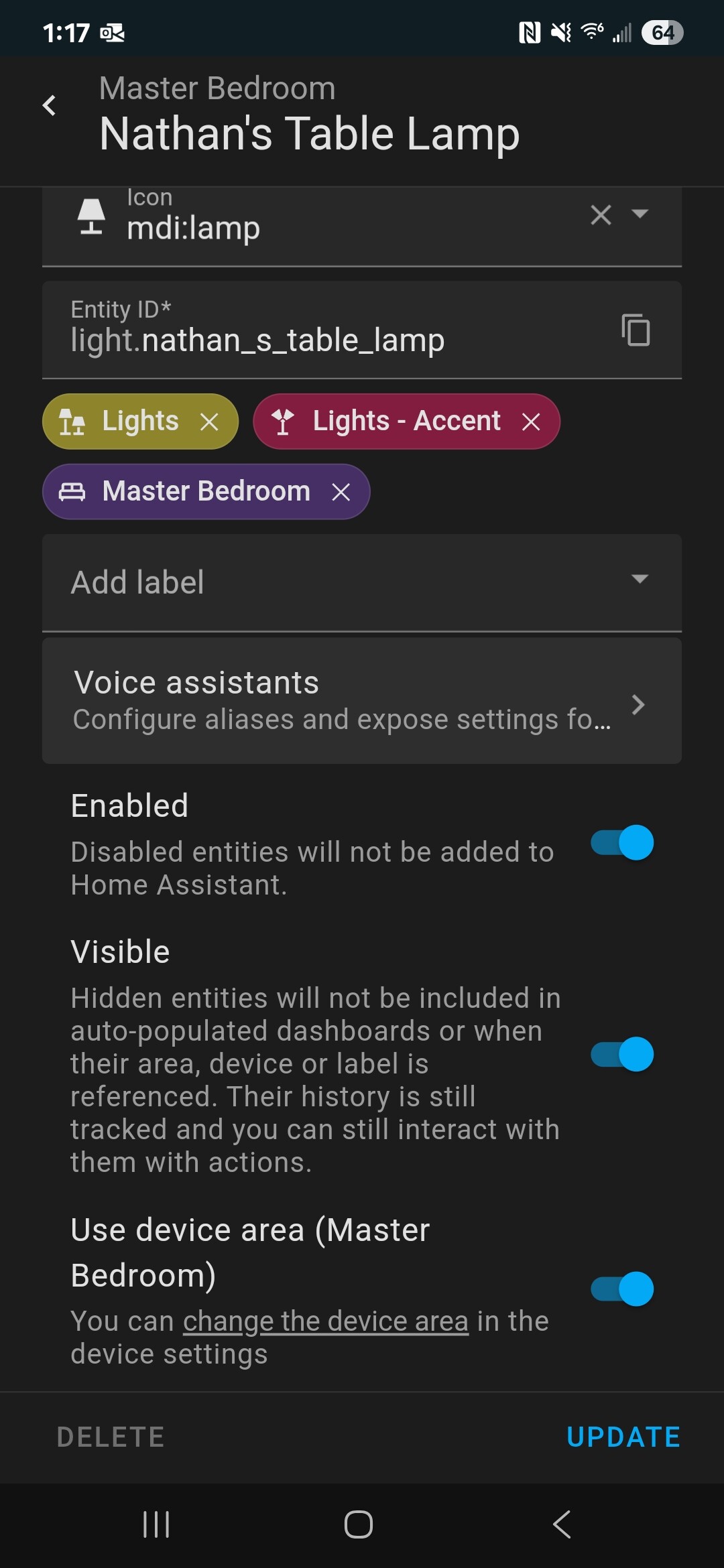

For. One of those hue entities. And. You may already see what I’m going to point at. You can override a device area. Per entity.

Show me this “hue area”
At some point this gets exposed as an entity. That’s how HA works.
And if the hue integration is doing that if honestly open a bug against it you should be able to override your entites.

Go override the entities
