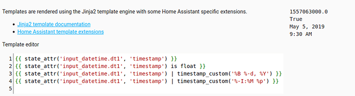

You do realize that this is rubbish, right?
{% set date = states('input_datetime.cgm_sensor_start') | float  %}
The state value of an input_datetime is a string value and converting it with the float filter produces zero.
If you want to present the state of an input_datetime in a desired format, simply use its timestamp attribute.
{{ state_attr('input_datetime.cgm_sensor_start', 'timestamp') | timestamp_custom('%B %-d, %Y') }}
{{ state_attr('input_datetime.cgm_sensor_start', 'timestamp') | timestamp_custom('%-I:%M %p') }}

How are you getting this to work? I’m simply trying to display an input_datetime in a template, formatted for 12-hour time.
{{state_attr('input_datetime.coffee', 'timestamp') | timestamp_custom('%-I:%M %p')}}
This code outputs “11:30 PM”, even though input_datetime.coffee is actually set to 6:30 AM. Is there a new way to do this?
sounds like it might be a timezone issue.
try this:
{{state_attr('input_datetime.coffee', 'timestamp') | timestamp_custom('%-I:%M %p', true) }}
or if that fails to fix it:
{{state_attr('input_datetime.coffee', 'timestamp') | timestamp_custom('%-I:%M %p', false)}}
‘False’ saved the day! Thank you!
