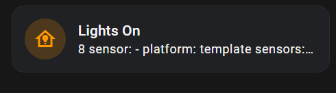

Hi many thanks for the help - i have followed your instructions and I have ended up with this
is that right? how can i get it to hid the platform: template sensor text?
thanks in advance
Can you post the sensor portion of your configration.yaml You have an alignment issue that is causing this issue.
thanks for the quick response on, everyone has been so helpful here - i deleted and re did what you listed above and its worked perfect now
