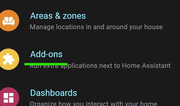

Ensure you have an editor installed in your add-ons
Editor
