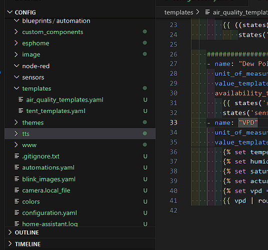

ok i am definetly going with the !include_dir_merge_list version where i can split up my files for organization. i now have set up a tent_templates.yaml and a air_quality_templates.yaml file in a templates folder. everything works in the tent_templates.yaml but nothing works that is in the air_quality_templates.yaml. if i use

this is a pic of the VPD sensor which is in the air_quality_templatesss.yaml file just showing it works.

ok i got the everything working. air_quality_templates.yaml was big indentation error. But as for mixing different entities in same file what is the issue. i do have binary sensors and sensors in 1 yaml and it is working? just getting into this but want to do it right the first time without even more ballistic learning curve. are packages not something i should look at in the future are they hard to setup and work around? P.S Great thanks for your help so far!!
