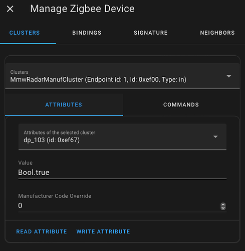

Has anyone figured out how to disable the LED light? I tried setting the dp_103 value (supposedly the LED) to Bool.false and 0 but it has no effect, and reading the value immediately after shows it having the value Bool.true
I attempted a manufacturer code override as well, but that had no effect either.
