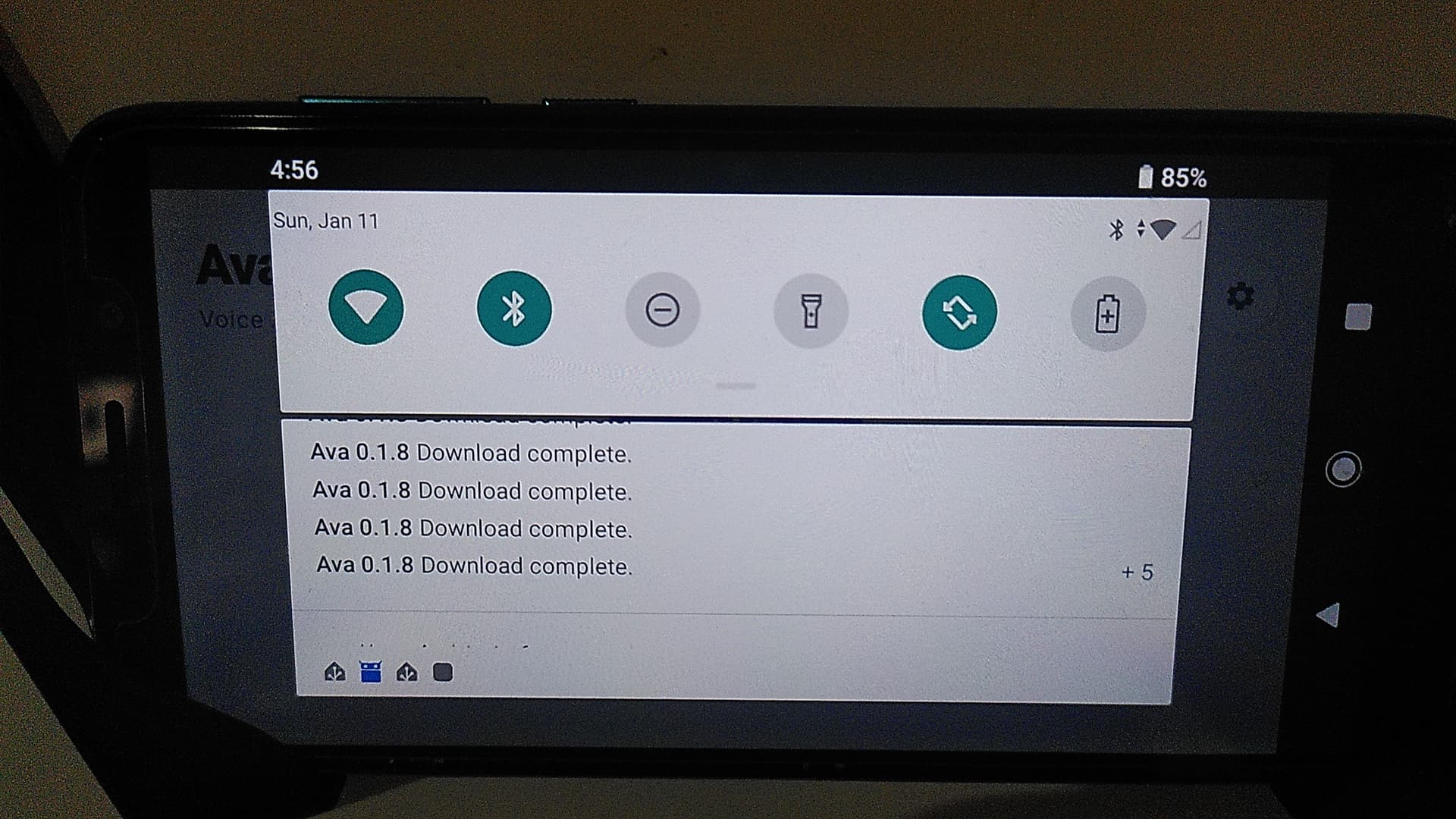

Updater needs a bit of refinement. Seems to like doing multiple downloads.

As noted above, the updater is very suspect and wasteful, that needs looking at ASAP.

On the updater: your concerns are valid. The current implementation is inefficient and overly aggressive. This has been flagged for immediate review and rework.
