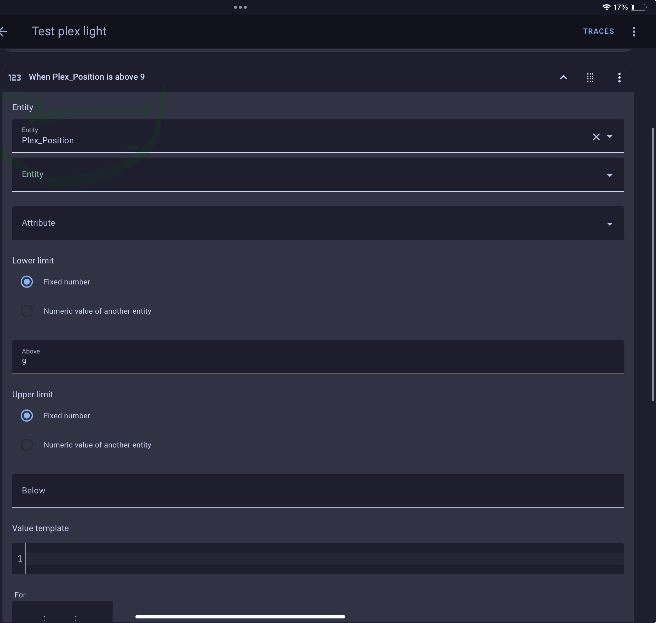

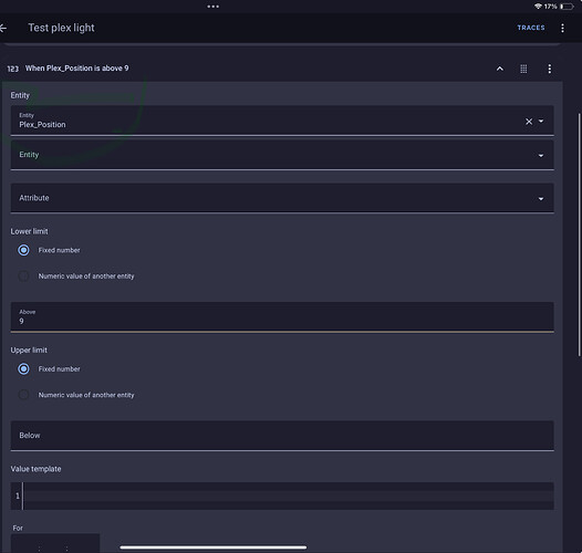

Thank you, I’m a very novice user, that’s the question, how do I call this sensor from an automation? I’m trying but I can’t see any of these sensors created in the code lines. Thank you.
I already have the sensor here, but I don’t know if I’m using the correct triggers, in this case a number to verify the position of the credit marker. Thank you in advance.
