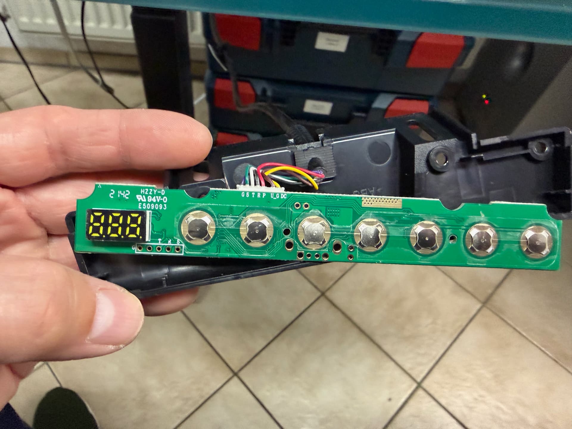

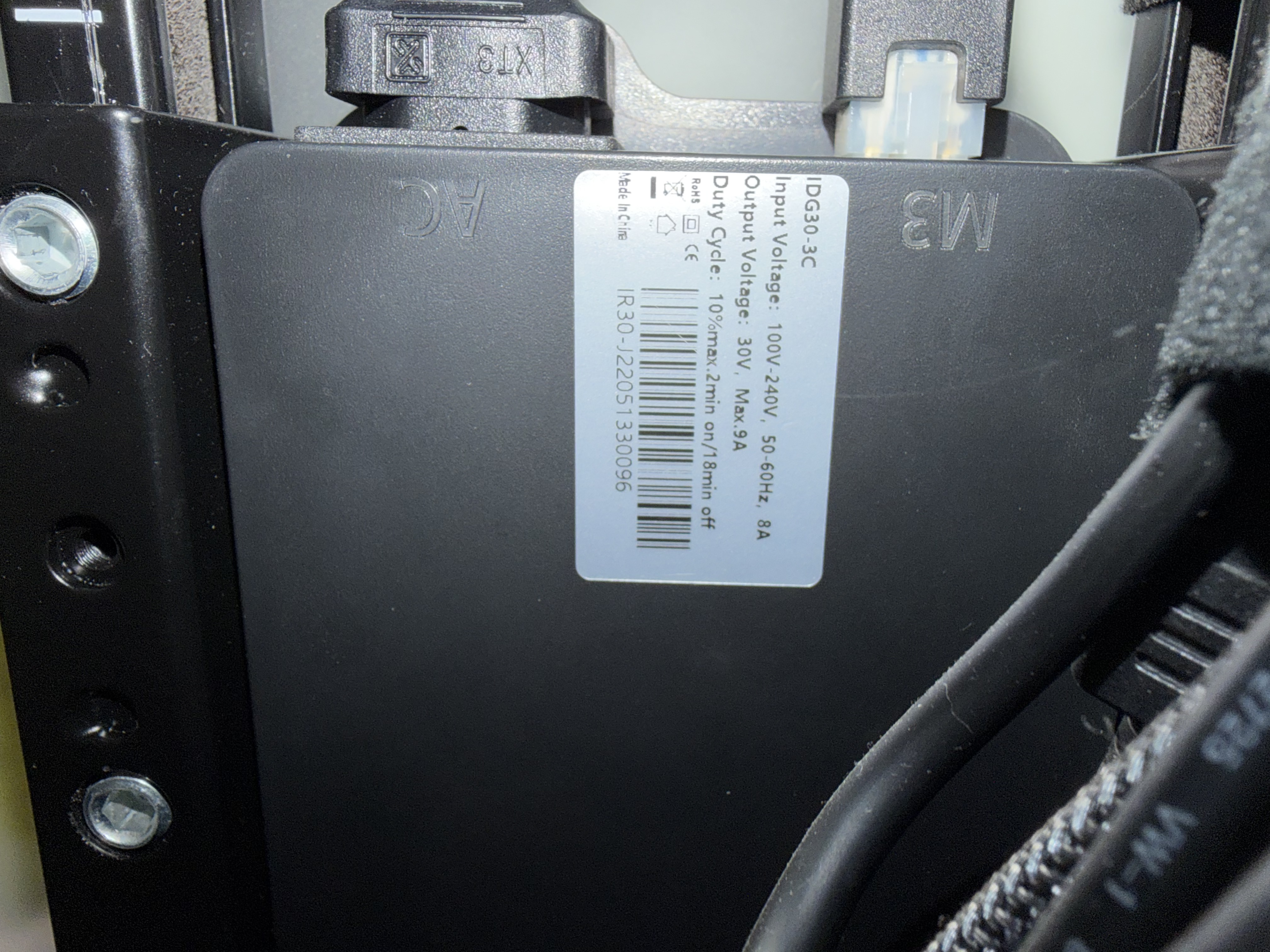

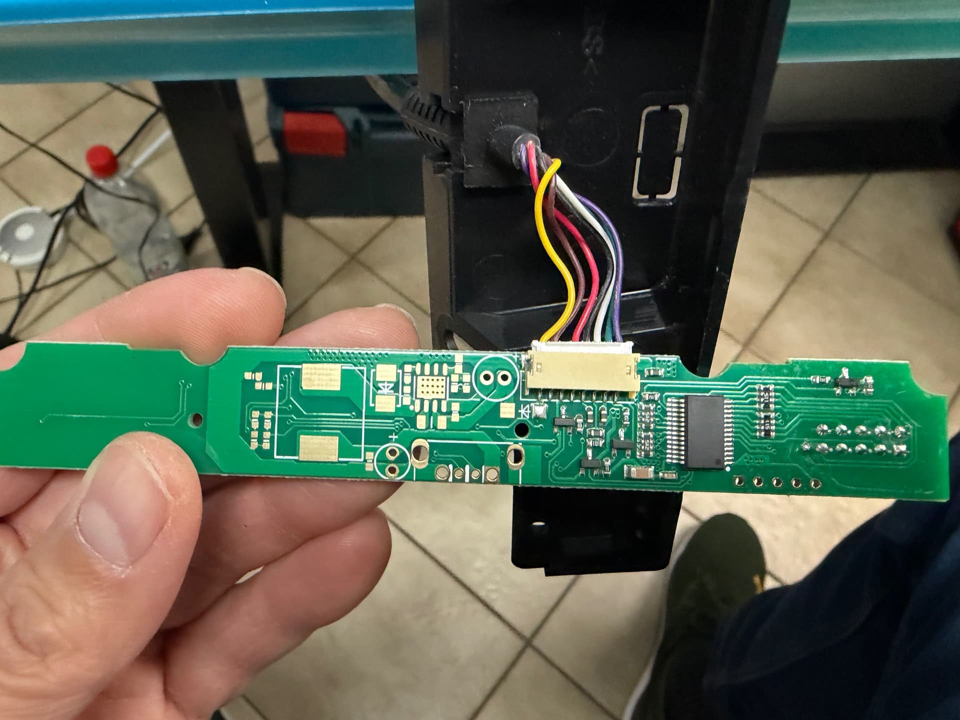

Hi guys,
Is there a possibilty to Check if my desk will also work?
I got a corner desk with three legs.
There is also a Controller with an rj50 Plug.
But there are 4 presets available.
But there isnt any Name of the Company.
I attached the picture of the Controller.
Gerne auch in deutsch per pn oder in einem eigene Beitrag
Cheers Robert
@Mahko_Mahko
i have seen that the controllerbox got the same letters on it: hzzy-m
but my touchpad is a different type. hzzy-d
There are 4 presets available.
Attached are a few picture of the touch board.
Can anybody tell my what code i could use to controll my desk?
Cheers Robert
