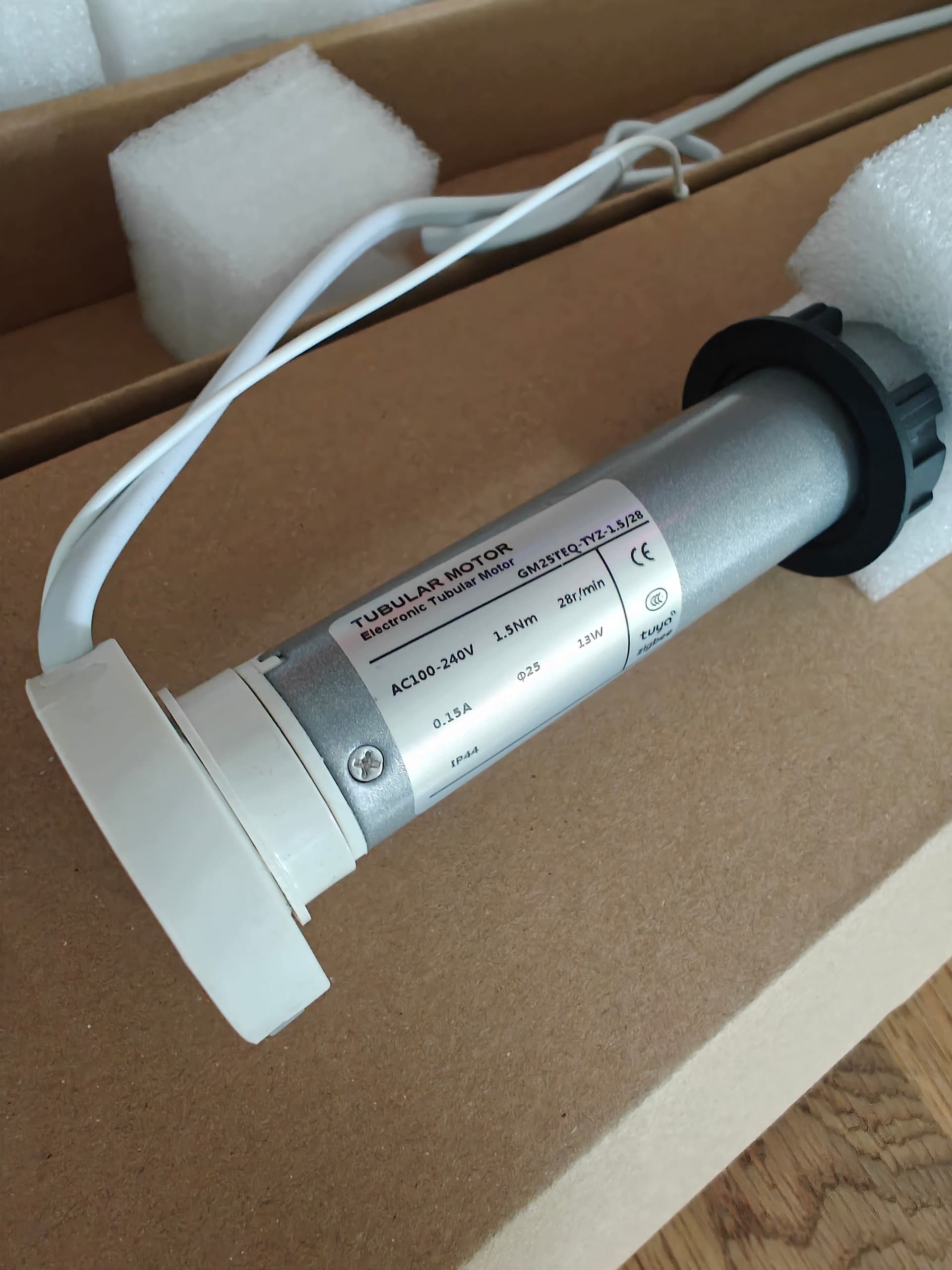

Tuya 120v tube motor, Blinds/cover, TS0601 - TZE204_xtrnjaoz
Hello, I am looking to integrate these new tube motors with home assistant.
I can not seem to find any info on making these work, and am tempted to buy a Tuya hub for integration.
I cant get Home Assistant to show any controls
